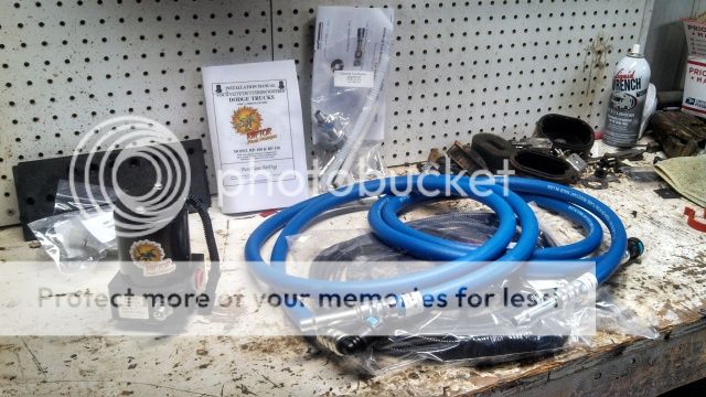

The in tank was a manufacture retrofit on these trucks
Kit comes with pump, lines, frame mounting bracket and sending unit kit to install new suction line.
Modding the sending unit took me longer then installing the rest of the kit.

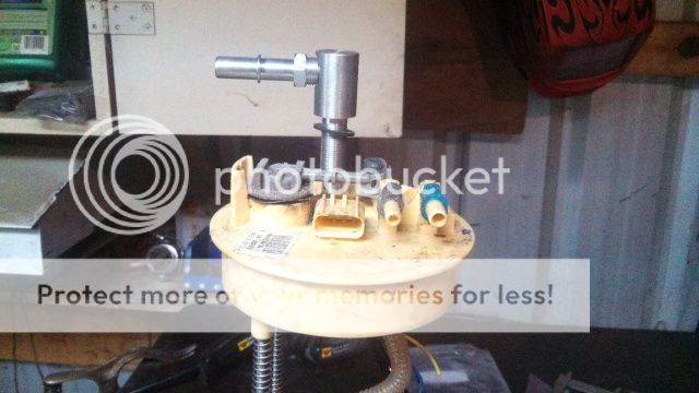

New suction kinda cool machined part
Stock pump gutted from the unit and new suction installed. ready to go back in the tank.
