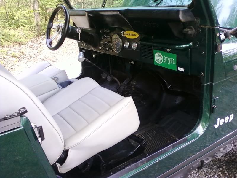

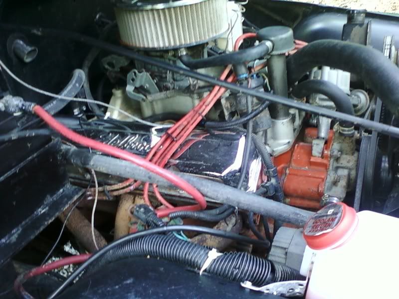

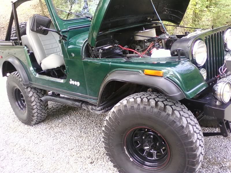

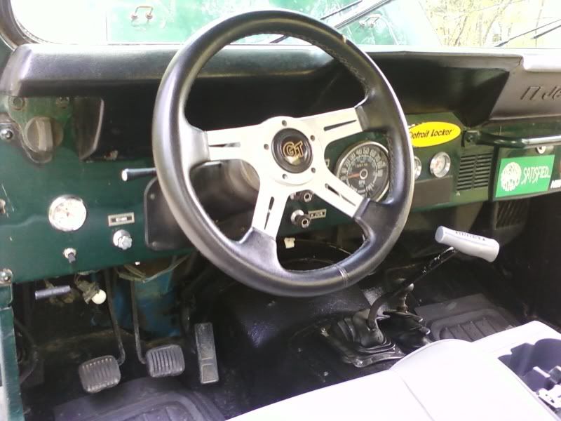

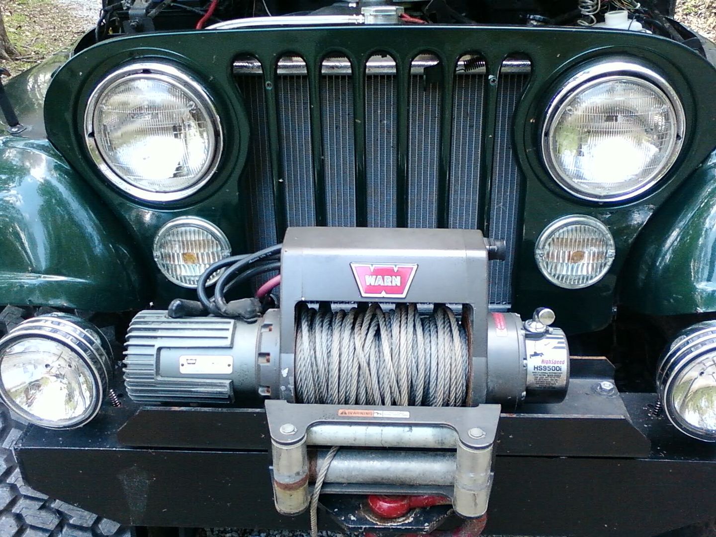

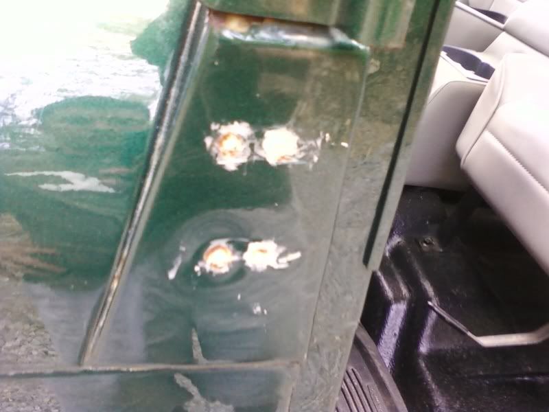

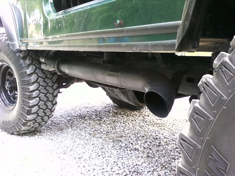

side exhaughst

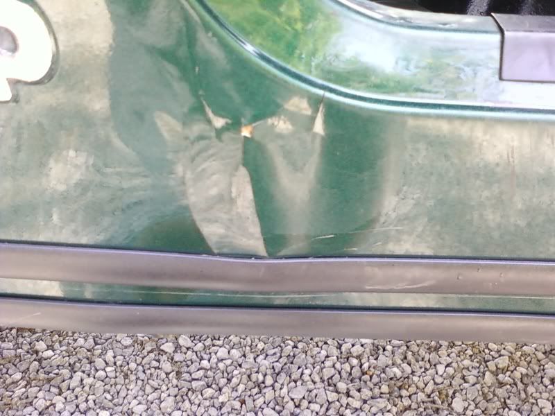

repaired holes near driver door

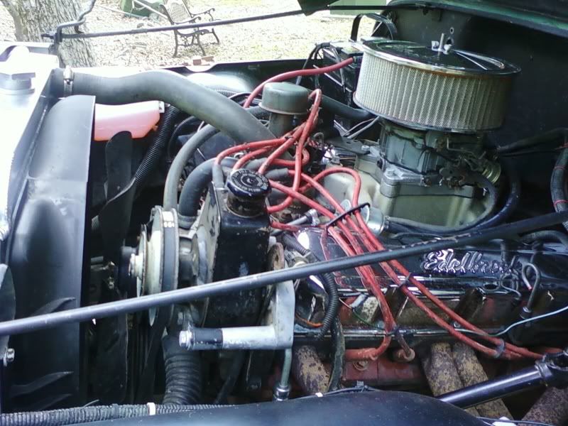

engine - pic 1
pic 2

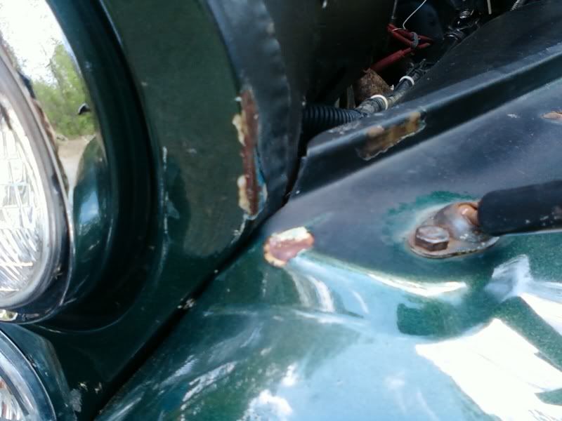

small rust spot near driver side HL

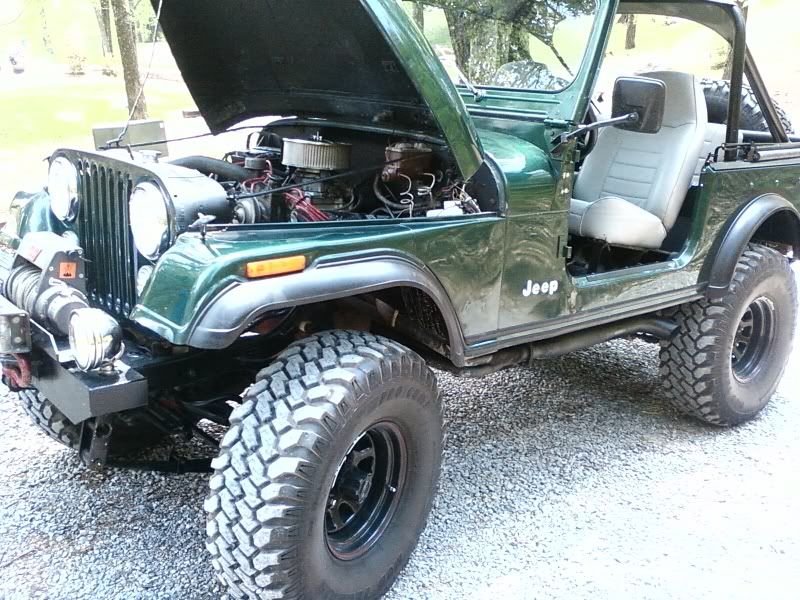

front
driver door

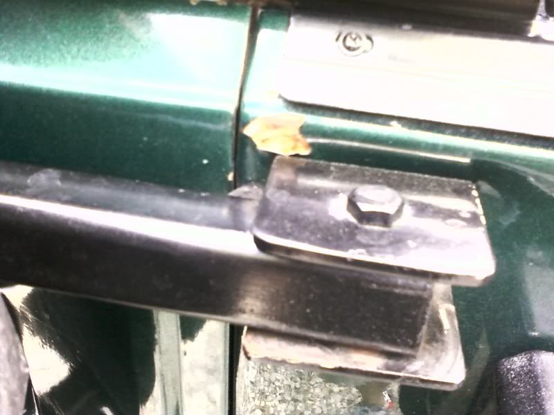

ding near driver door hinge
front shot
engine again

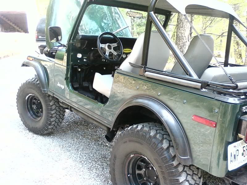

front again
passenger
rust spot on tailgate
rear shot

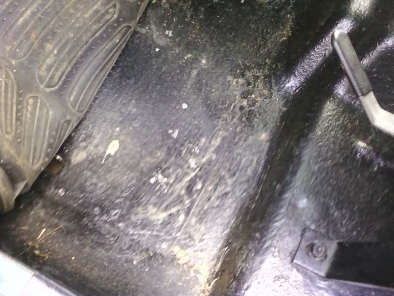

only rust i could find on the floor was on the passenger floor and it was minimal - at least all i could determine was it was only in a couple of spots and looked superficial
#16 ·
The underhood wiring looks suspect. And you need someone who can check it carefully for rust. I think you're missing it. That spot near the lower left door hinge looks like a rust-out. Did you look on the inside there? The bedliner-covered interior is another warning sign. It's a great way to hide serious rust problems. And if there's one rust-out showing, you can bet there are plenty of others you can't see. I'm definitely not saying it's a rust bucket, but from the pictures, I suspect that it is.
#17 ·
if i saw rust (about a dozen places) i tried to look at it from all angles
the two "bullet holes" near the driver door looked to be the worst (deepest)
and im not sure what u mean by "bedliner"
he did have two small black rubber mats on the floors
the floors have been "rhino lined" but it looks like a think coat or a generic coat was sprayed as its not quit as "Knobby" as other rhino liners ive seen ... again thats just my opinon
u r the expert - so im not knocking what u are saying, but i took pics of the rust i saw
i crawled through it and under it with a flashlight and even "tapped" welded spots but not crumble, no flaking, nothing. the headers had some visible wear/ corrosion, but ive seen that in a lot of cars

jim - what about the wiring looks suspect to you?
how can u tell?

There is a wire draped along the left valve cover that doesn't belong, and several along the right valve cover that are hanging loose. They may be innocuous but I can't tell from the pictures.
The bedliner I was talking about is the Rhino Liner interior. It can be a nice, tough, sound-deadening floor covering, or it can hide a lot of problems.
That could be a very good Jeep, and if it really is rust-free it would be an excellent buy IMO. If the paint, body putty and Rhino Liner are hiding rust you could have a nightmare on your hands in a year or so.
