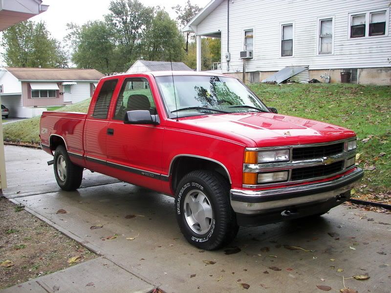

Hi! Used to be over in the ford f-series board sold my truck went without a 4x4 for a few years and just got back into it.. Got a 98 Silverado z-71 4x4 5.7/auto leather, power everything 98k.. So far i love it and get descent gas mileage (high teens) I am looking at improving this a little bit and getting some more pep.. What is a good intake setup will the cheap short ram kits do the job? also looking into exhaust options.. i noticed that these trucks have duals back to the muffler. How do they sound with the muffler removed and duals the rest of the way out the back with some big tips? Also how can i find out what gear ratio i have i am thinking 3.73 as i can run 60 mph around 1400rpm or so.

Nice truck liftedchevy /ubbthreads/images/graemlins/cool.gif

thanks, i love it too shorts
