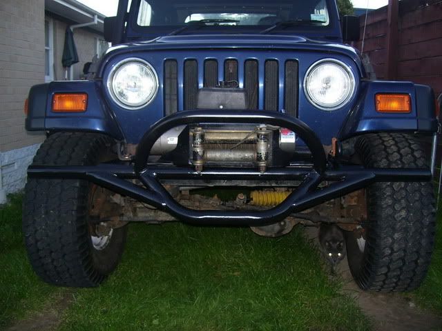

What do you guys think of this bumper?
Does it look better with our without the tubes?

Olin...except for a pic of the bumper without the tubes...no other pics...but a little info...
The main part is made out of 2"x5"x1/4" rectangular stock...pretty easy to cut and bend.
The attaching plate is 1/4" plate steel bent over the front frame. Note: The CJ is about 4" more narrow than the YJ or TJ...I picked the 1/4" plate because my front frame has been hacked on over the years...first, it was a POS Smittly Built 'tubular' bumper...then I did an SOA...so I wanted a bit more support across the front...especially for when I add a whinch. So...the 1/4" plate is just bent around the front frame and bolted on in 6 places. We had to weld in some nuts due to access problems.
The rest is just 1.5" tubes as you see it.
A lot of good points were brought up.....as for protecting the hood in a roll over....if my roll over is bad enough to damage the hood....I think the hood is the least of my worries.
For what I do, a stubby would have been just as functional....if not more so.....but, we had the time and material....so this is what we came up with.
