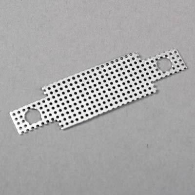

Holley 26-39 - Holley Fuel Bowl Vent Screens
Fuel Bowl Vent Screen, Fits Holley, Each $6.95
Holley 26-39 - Holley Fuel Bowl Vent Screens – SummitRacing.com
