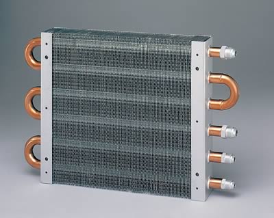

I have always thought that the areas for the convertable mechanisms would be great. One tranny, one oil. I've just never really looked into it with any depth. I've got a few dents in the floor pans underneath the seats, so your tranny cooler position would bother me. What about using a double cooler up front.
Flex-A-Lite 45321

Quote:
I'm banking on the yet to be made skid plate to keep it out of harm's way.
As to having a double cooler up front, I just ran out of space. Below illustrates how tight things are in front of the radiator. What can't be seen is that the center two slats on the grill had to be notched on the back side for clearance of the motor hub on the aux electric fan. The center-most bulge on the hub actually comes close to being flush with the face of the grill. Also not enough room under the winch plate. Just barely can fit the 10 in. x 7.5 in. x 4 in. cooler w/fan under there. The steering box and brace get in the way a bit to utilize all of the area.
